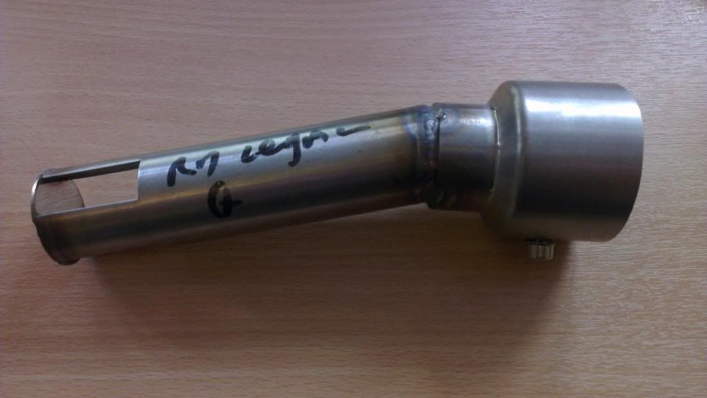

Is the one you bought the same as this one?
  • Posts: 8289
  • Bike: 'onda Varadero XL1000v9, 'onda CX500ec '83, GSX14 '06, DL650 K6 (Blue) R.I.P,
Re: Is this any good ??? only £100 ;)
« Reply #44 on: January 15, 2014, 17:47:29 »
yep that's the one.
it makes it just a tad louder than stock but a fair bit deeper in tone.
she still barks when you give it a handful  :auto-dirtbike:
