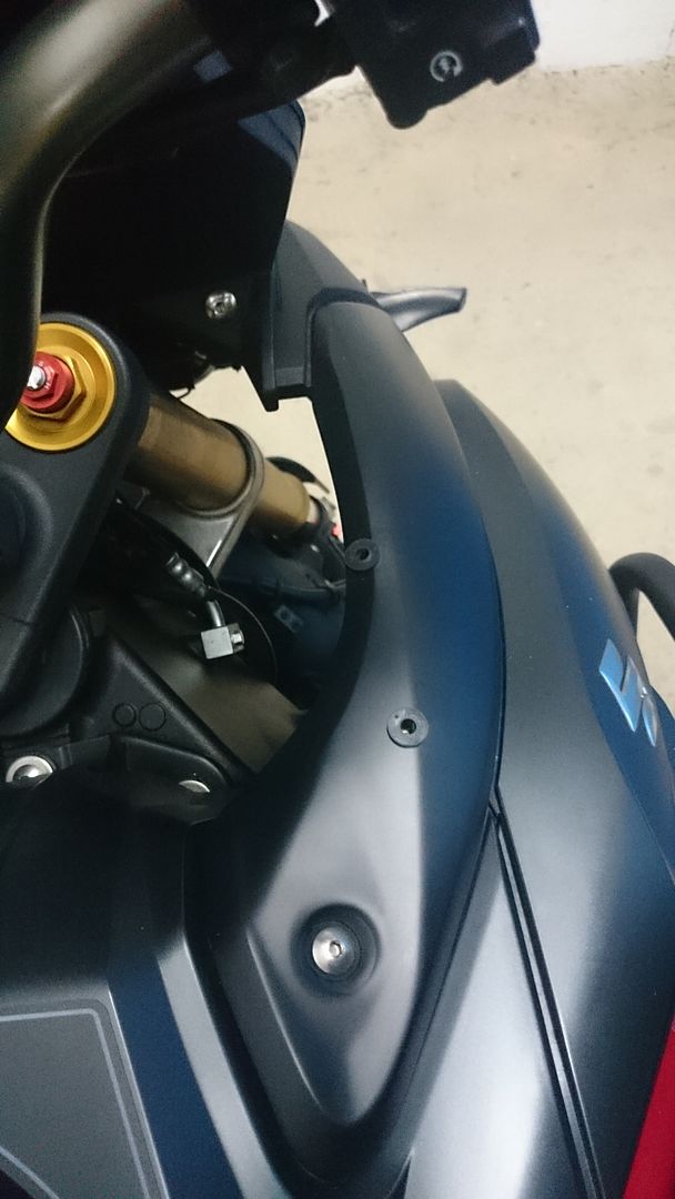

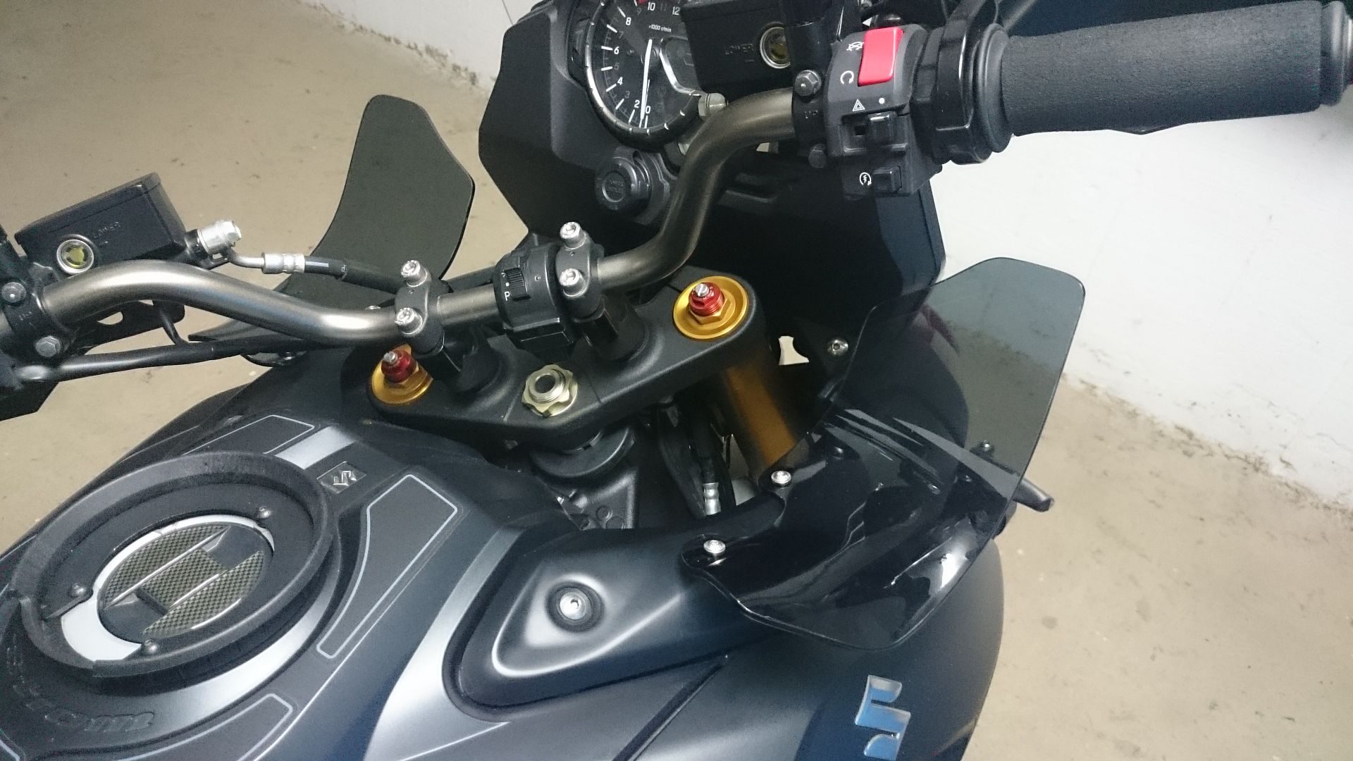

After seeing at spanish forum one bike with wind flaps installed and reading that the owner was more then happy, I decided to give it a go:
Holes position:
Installed:
They are for BMW GS1200Adventure, sold on eBay or BMW dealer in clear or tinted (I've chosen tinted). They come with all hardware needed. I copied holes position from spanish forum. The spanish bloke who installed them swore the wind hitting your body and the noise were dramatically reduced. I'll see tomorrow on my way to work.

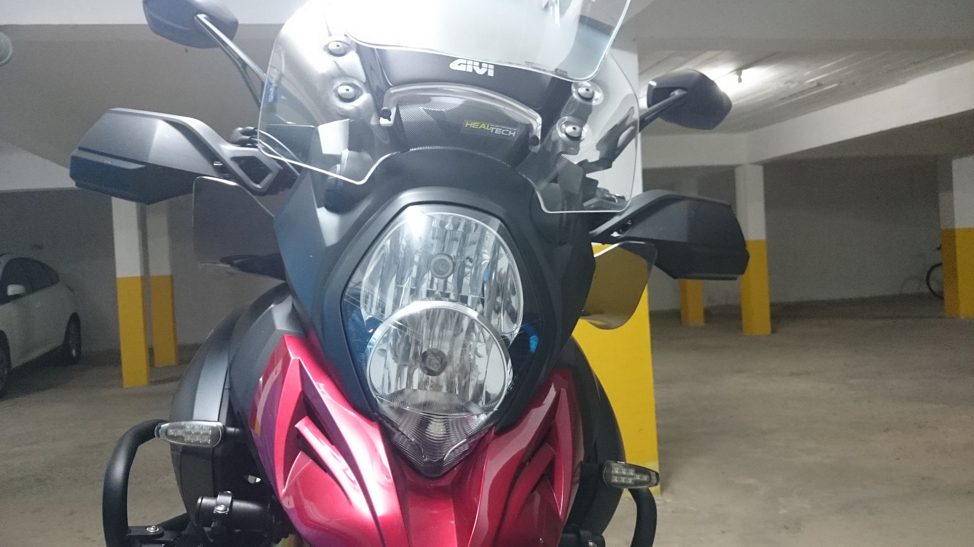

« Reply #4 on: October 14, 2015, 21:20:21 »
I took a bit longer ride today and can say this:
- Wind coming into helmet from bellow is gone
- Wind hitting my waist and chest is gone
- No buffeting, just like before installing deflectors, as I have Givi Airflow
- Up to 80km/h, helmet is completely silent, then the noise begins. My helmet is noisy, AGV Compact Course, that's why I ride with bluetooth earpieces, they work as earplugs and phone bluetooth in the same time.
So, it was not worthless upgrade. I like my bike better without deflectors but they do help in controlling the wind.
